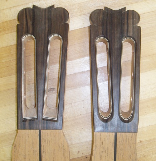

I'm building my 2nd. This time I'm designing my own head instead of using a historical one. I've incorporated my initials in the shape, 'DMD', now I'm trying decide on square ramps or round ramps, I'm leaning toward square, but I would like some other opinions. Square or Round?

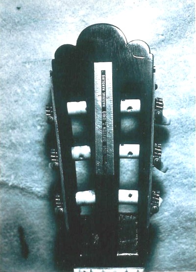

Thanks Steve, nice feedback, square, although uncommon, is really not too far off from tradition. Here is an 1888 Torres head with square ramps.

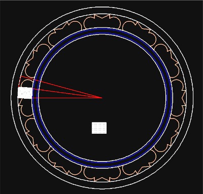

Nice idea on the rosette, I've been working on one that replicates my crest pattern, but not much success, yet.

The square slot that is traditional is to end the ramps square to the nut, not slanted or with relief as you have added. This makes the look more contemporary. The main reason why many historical examples have square ramps is usually because the head angle is very shallow and the ramps needed additional length for string clearance which is less a problem when the head angle is greater. If you check out the head angle of most classical guitars that have rounded ramps the head angle will almost always be over 10 degrees while earlier guitars would use between 6-10 degrees.

Marc, you are right about my tradition comment, which I have edited. I took at a look at a bunch of pictures of pre-war Martins that I have in a folder and many have rectangular openings, squared at top and bottom. So, my memory is just not good about that. I do like the idea of mirroring architectural aspects of the instrument in the rosette.

Thanks Shawn, your right about the slant out of tradition, it is my own, but not too far from tradition, I think. I was thinking about squaring with the nut but with the angle of the slots I will be running very thin in the center. I had some trouble with strings clearing the head on my first guitar, that is one reason I wanted to try square. Not sure what you mean about relief, do you mean the bevel around the edge, the bevel I copied from 1978 Miguel Rodriguez Jr..
The 1888 Torres example with square slots, the head looks to be at an angle greater than 10 degrees. What do you think?
PostPosted: Fri Sep 08, 2006 9:02 am
Posts: 606
Steve, I didn't notice until you pointed it out, the 1888 Torres is also squared on top.

I've always liked the squared look. Hauser did it. Also, John Gilbert was the first one I've seen that did the slanted squared off channel, the way you did (not saying he was the first, just the first I've seen). Putting an angle to the bottom of a slot is done for a reason. It provides extra clearance for the 1st and 6th strings, where the break angle over the nut is the steepest and thus most likely to contact the headstock veneer.
Speaking of which -- I really like the way you've beveled the headstock veneer on the inside of the slots. Very nice. Did you do this by hand or use a router bit or some such for this?

Thanks Michael, I was hoping to get your opinion. I can do the round ones in about 30 minutes, the square ones take me a couple of hours. Hausers I think are slanted in Courtnall's book, but they are just barely because the slots are nearer to vertical than mine. Fletas and Torres are square with the nut. I haven't seen Gilberts, I need to take a look. The upper portion of the headstock veneer is beveled using a chamfer(sp?) bit on a router table. The ramping and beveling on the the lower portion I do by hand with a chisel and waterstone nearby. My lower through slot is round, I'm trying decide if I want to square it parallel with the ramp.
